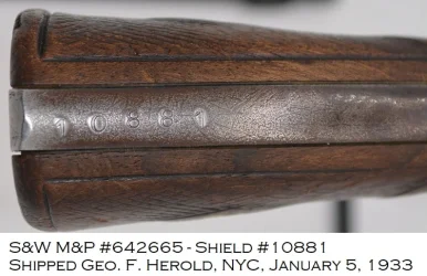

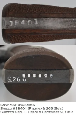

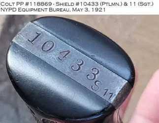

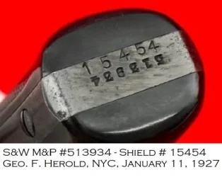

I have included a small selection of stamping images. Please note the manner in which the stamp was applied.
Typical Patrolman shield stamp. Better done than most but the 5 and the 4 give evidence the obvious (but well done) handstamping.
An excellent example of a gun that was owned by Patrolman #10433 who was later promoted to Sgt and had to stamp his Sergeant shield number on the gun. The S in front of the number denotes it being for a SGT shield.
Another Patrolman/SGT gun. This one has the Patrolman shield number on the backstrap and the SGT shield on the butt. Note how the SGT shield nearly damages the serial number.
Another typical Patrolman shield stamping.
