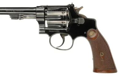

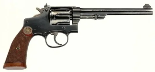

A O Niedner bobbed the hammer on this 22/32. The regulation police grips are original to the gun shipped in 1920.
