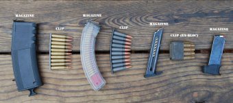

Just a nit to pick; it's a magazine, not a clip. :)
That said, are you following the directions in the manual as regards to loading the magazine? Simply pulling the loading button down and dropping a handful of rounds into the magazine will cause feeding problems most of the time,
Just a nit to pick; It may be a magazine, but I refer to it as a clip. :)
Thanks to all who answered my original question. I'm going to try some federal bulk and if that doesn't work, i'm going to go to CCI. As for the nitpickers, i'm 40 years old and been shooting since I was 6. So I know the difference between clips and mags. Sorry that my use of the term"clip"upsets you. Clip clip clip lol. Geeezzzz, ease up.

Nobody's "upset"; some people just like to use correct terminology.
