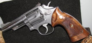

19-3 finish
glev,
I also have a 19-3, Serial # K7923XX with a unique finish. It is not as bright a nickel and not as dull a SS. I have sent a LOA to S&W to find out what finish the gun was shipped from the factory with.

To all those who are upset with me, I have spoken to Roy my self and my Dad talked to him two days ago. He said that a letter would not be helpful because it would not include a conclusive answer to the "mystery." Roy was very personable and looked up the gun by serial number. He was able to give us the manufactur date and details on some of the factory options, including target trigger and sights but he did not find info on the original finish. This seems strange to me. His opinion was that we should have the gun professionally tested to determine if it is some type of refinishing or possibly (but unlikely) a custom gun. He also said that if it is stainless, he would be interested in seeing the gun because it would be quite special.
So -
Mr. Jinks told you the mfg. date.
Going by the FACTORY RECORDS he thinks it could
be a refinish.
If it is STAINLESS he said it would be "special"
Your low quality pictures are not definitive.
So without having the frame metal tested by a professional
no one will ever really know.
Bummer.
katanski, please let us know what you find out from S&W.
I have a 4" 19-3, serial 2K 900XX that looks identical to yours. Not stainless, but not nickel either and looks flawless. I'm curious as to what you find out. Regards 18DAI
There is really no need to run one of these guns by the guys at NASA to determine what its made out of. As has been suggested, scratch through the finish and see if it turns blue when you put a drop of cold blue on the gun.
I would use a little diamond burr on a Dremal tool. Under the grips, cut a little tiny divot in the frame. Just a couple thousands deep. If you can see a divot, its deep enogh. Put a drop of cold blue in the divot. if it turns blue, the gun is carbon steel that has been plated, almost assuredly it has been hard chromed.
Armoly in Fort Worth did TONS of cop guns around here. Stainless guns were very hard to find. Take your 19 and get it plated, it looks and acts just like a stainless gun. The color is almost an exact match for stainless.
There is the off chance it was mismarked at the factory. Possibly. Slight premium if someone wants a mismarked gun. I wouldn't pay extra for it, others might.
I don't think a letter will help either. If it was marked as a 19 but, was in realty a 66, I suppose Smith would still think its shipped as a 19 and, thier records would indicate that.
I had a model 36 once in blue finish. It got some water on it from rain, and showed a couple of rust spots. I sent it back and had the factory refinish it to stainless. I lived in South Florida and the humidity was horrible. The factory sent it back and every one thought it was the model 60...but it wasnt. The factory did not stamp the frame with a refinish mark...so it was done at the factory. I wonder if maybe yours might have had the same fate.,
Just to clarify, a gun cannot be "refinished" to stainless. The designation "Stainless steel" indicates that the base metal that the part is made of is a steel that is highly resistant to rust. Your model 36 was made of carbon steel, that is prone to rust, and was plated with something to protect the steel from water getting to it and causing it to rust. Carbon steel cannot be changed into stainless steel.
(Well, I suppose it could be but, it would involve melting the entire gun down and changing its properties before being converted back into a gun again.)
Hard chrome is an exceptionally tough and durable finish that looks, for all the world, like stainless steel and, shares the same external properties. Actually, its MORE impervious to corrosion than stainless steel.
