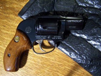

I own an antique S&W .38 spl. Recently, had the opportunity to buy a mint used snub nose S&W .357 Clone & jumped on it.
I like the option of shooting it with .357 or .38 spl. Reasonably sure metallurgy quality was well tested before manufacture of the line. I came to really like the little rascal.
